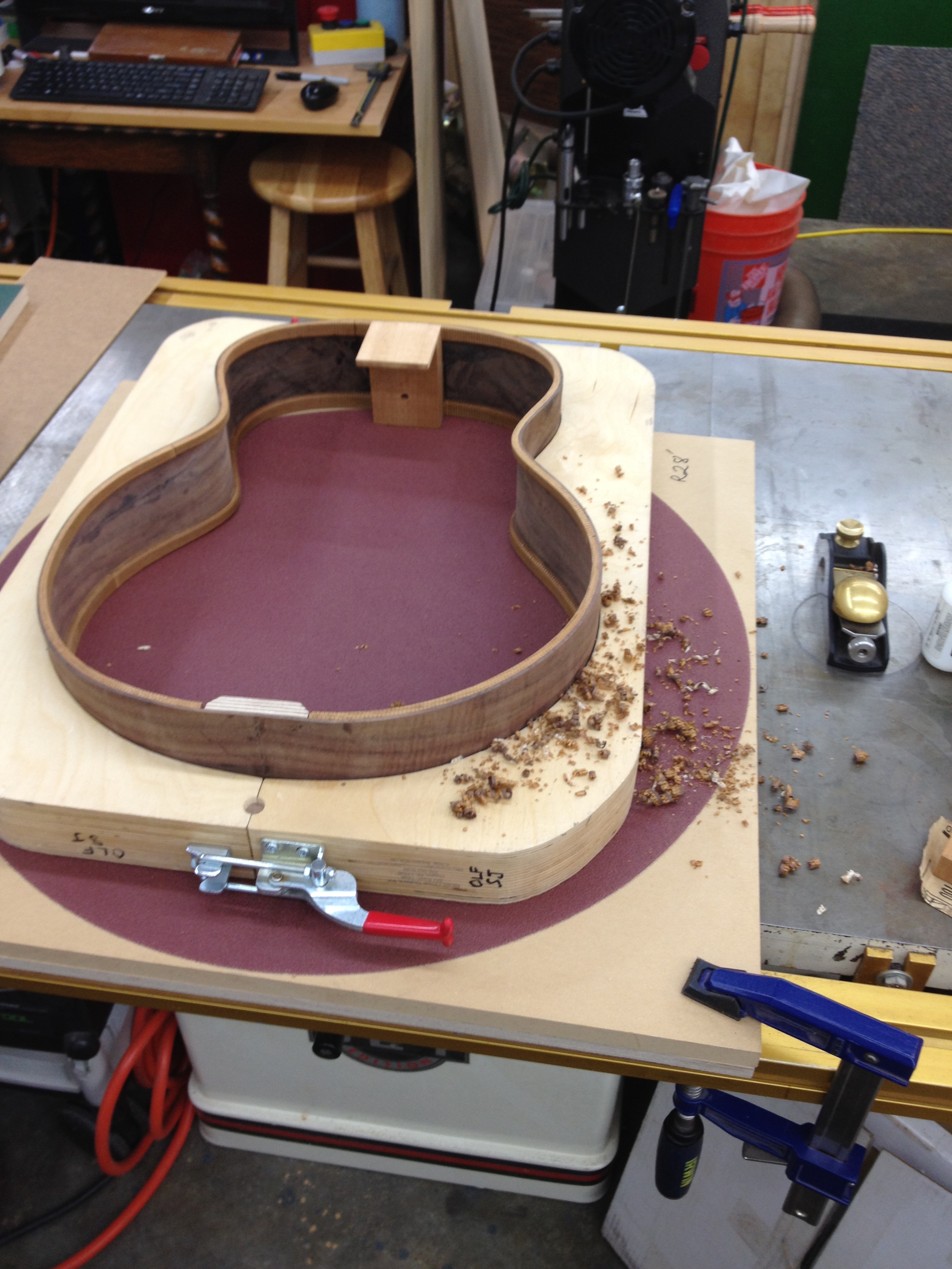

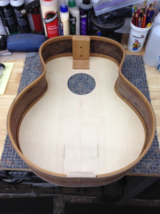

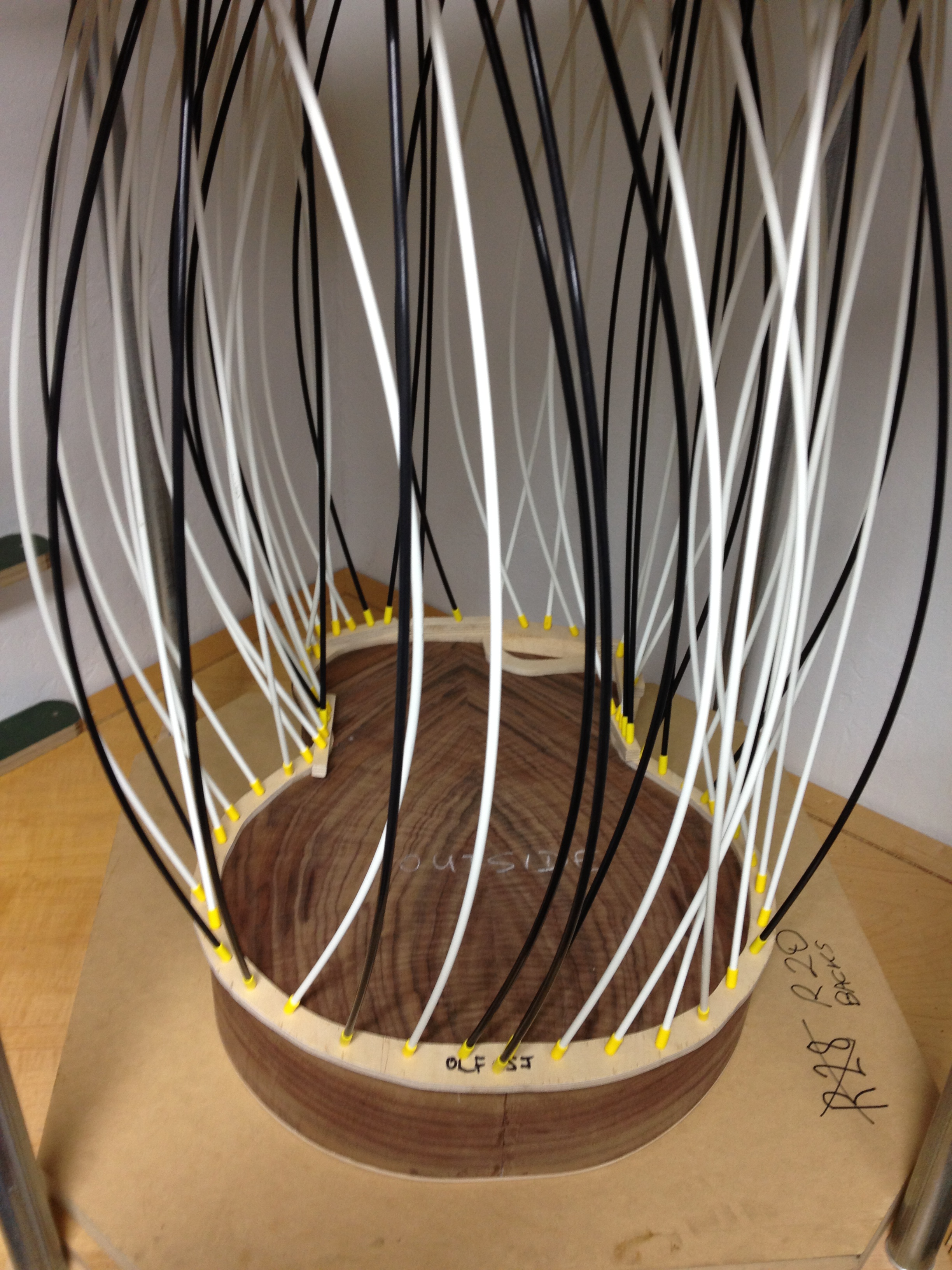

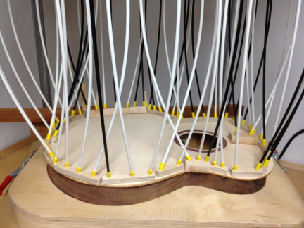

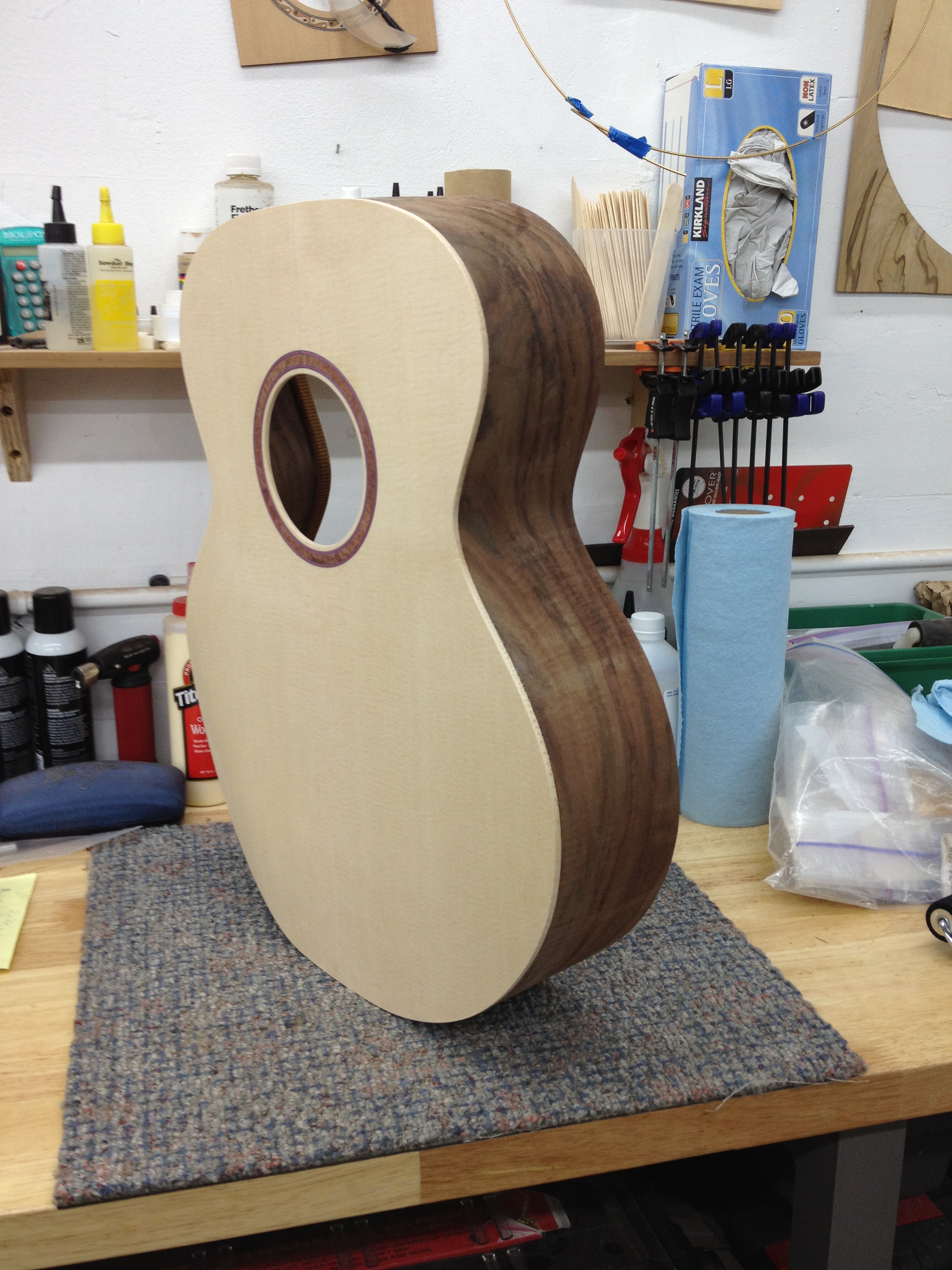

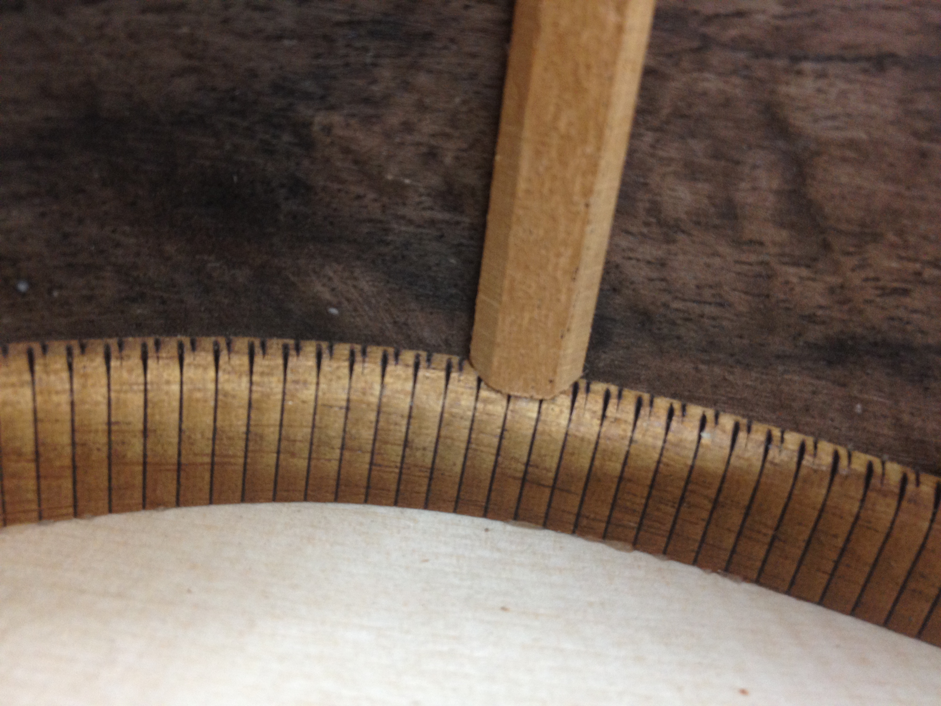

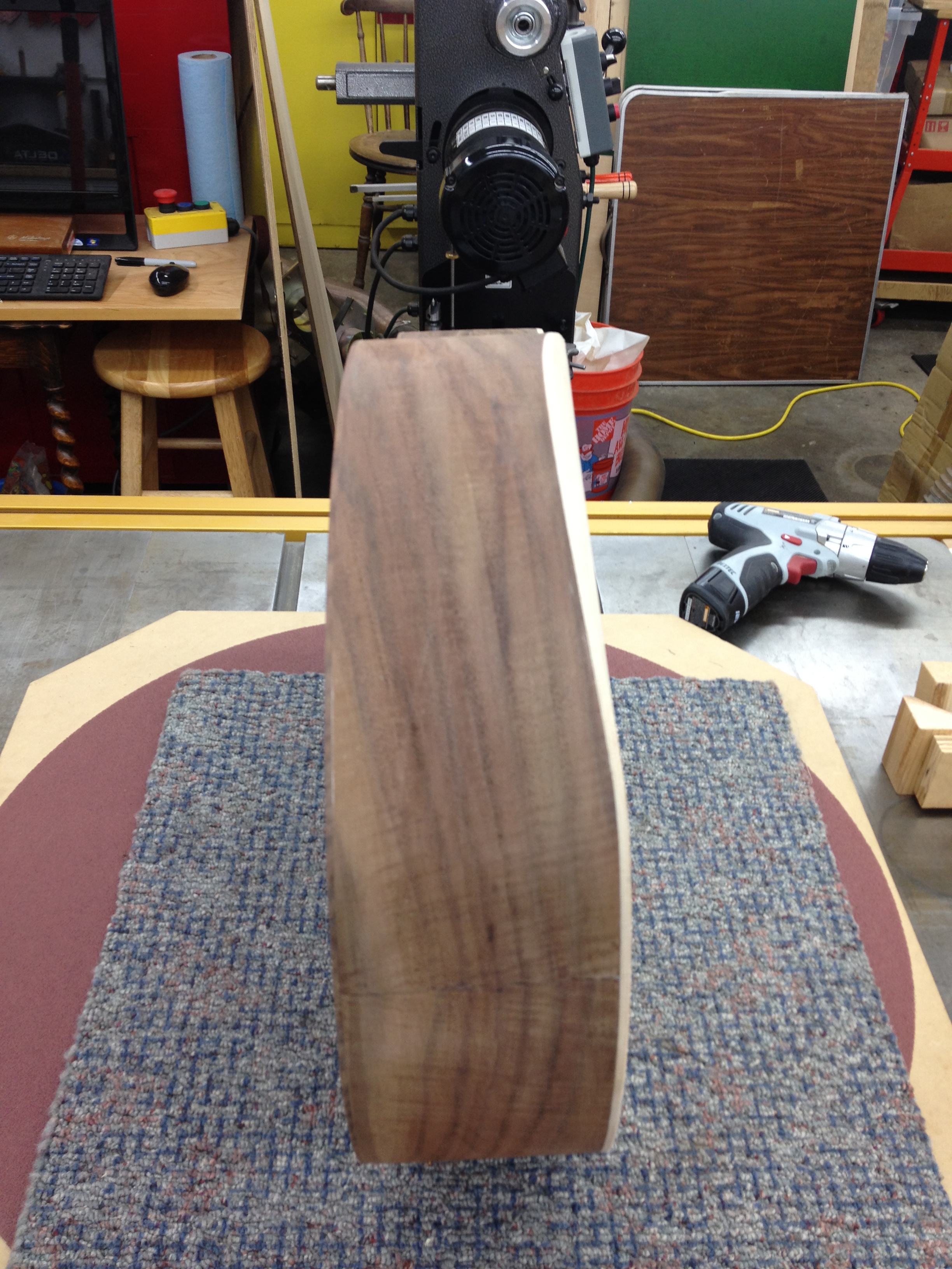

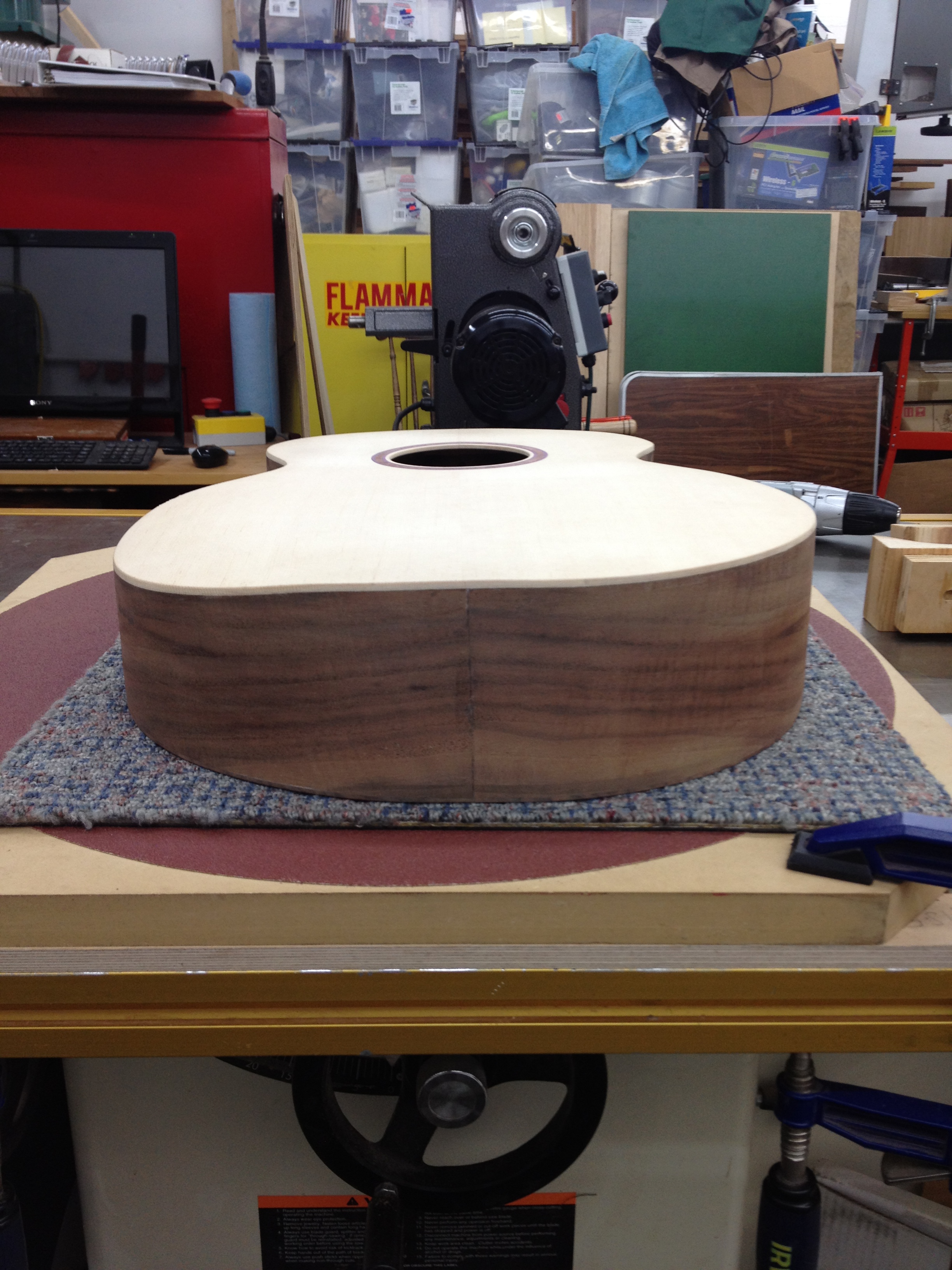

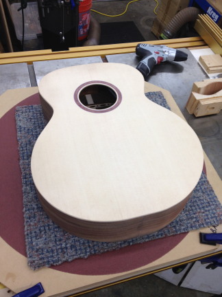

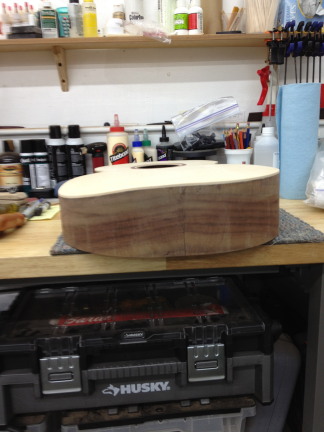

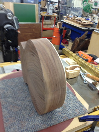

So here's what happened Friday night:

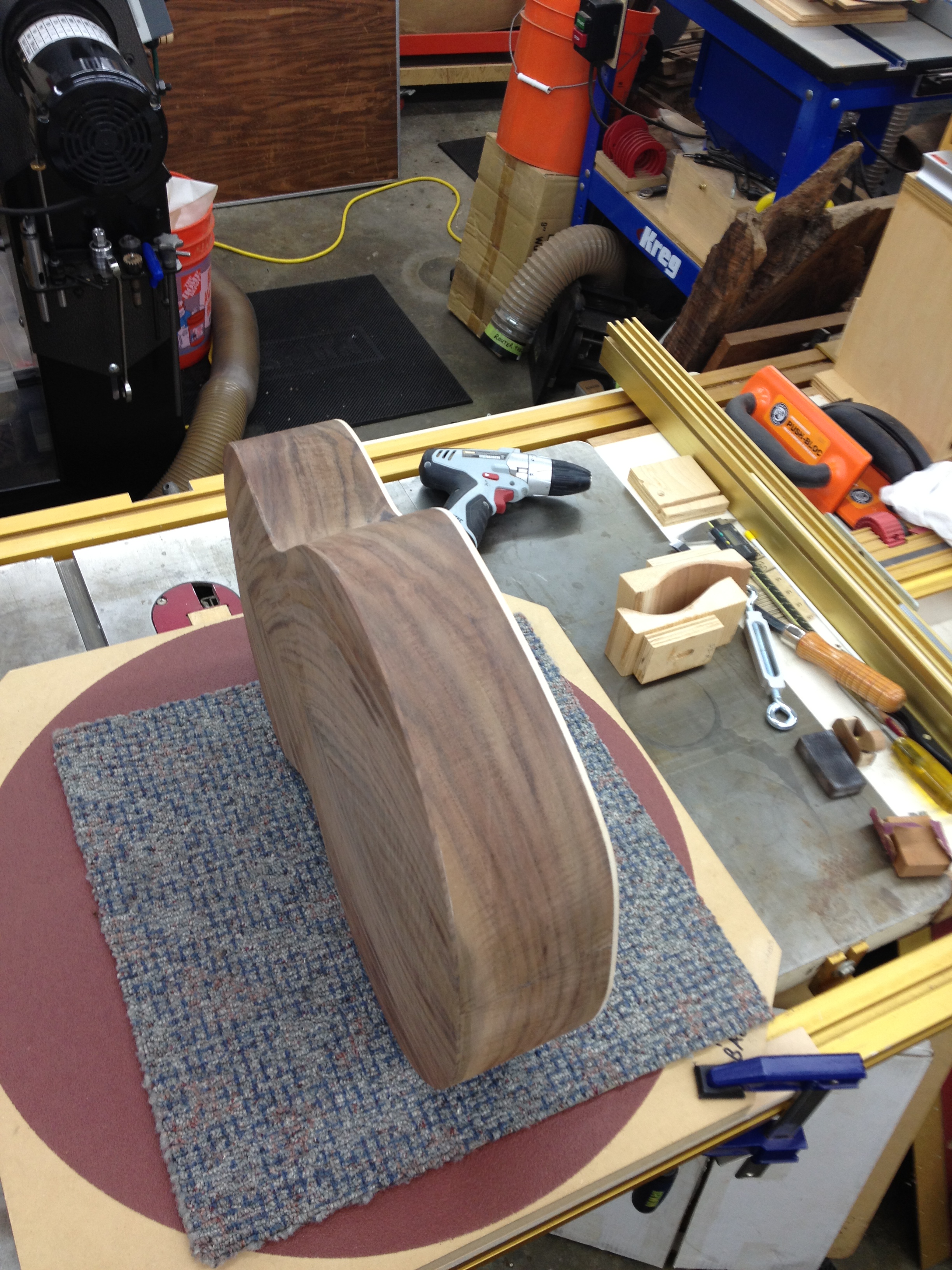

I made the decision to glue the soundboard on first. Normally, I glue the back onto the sides first so that I can clean everything up nicely, however, I had several unknowns with this new smooth bevel idea of mine, such as a) was it really stiff enough without any braces, b) how hard was it going to be to glue in the go-bar deck, c) are the kerfed lining surface angles all correct, d) was I going to use a pinless bridge or normal pins, so I'd need a bridge patch, etc, etc.
So, I set to getting the soundboard and sides to mate nicely (using a nice sharp plane and a sanding dish). Then I did a trial run at the clamping setup that I'd need to do in the go-bar deck. Immediately, I found a problem. The smooth bevel is at too steep an angle for the little wood blocks to "stick" on the soundboard - they slipped off every time I wasn't looking! I found a simple solution in the form of a bar placed at the edge of the bevel so the blocks couldn't slip off [:Y:]
Here's a bunch of pictures showing the process:
It glued up without incident - just like any normal back or soundboard. I love it! Here's what it looked like after I'd routed the excess off the soundboard:

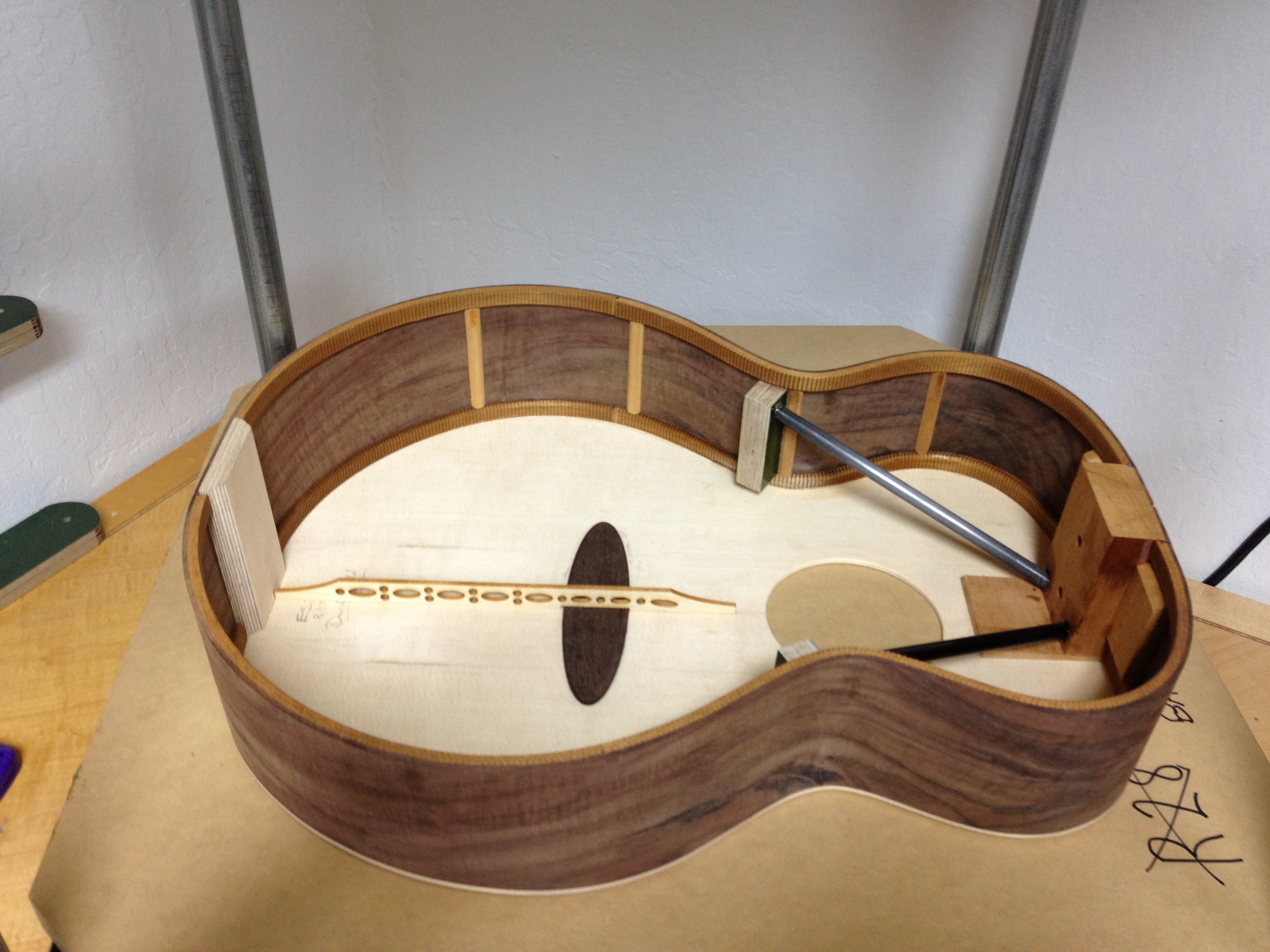

Then very late at night, I made some side braces from some (zero cost) scraps of mahogany and glued them in, one side at a time. The astute among you will also notice that I added some "wings" to the neck block. This was because the walnut sides split vertically in several places near the neck block - there was some wild grain in that area, and I guess it wasn't that strong. The added wings provide a very strong tie into the neck block as well as providing a solid backing for the wild walnut grain.

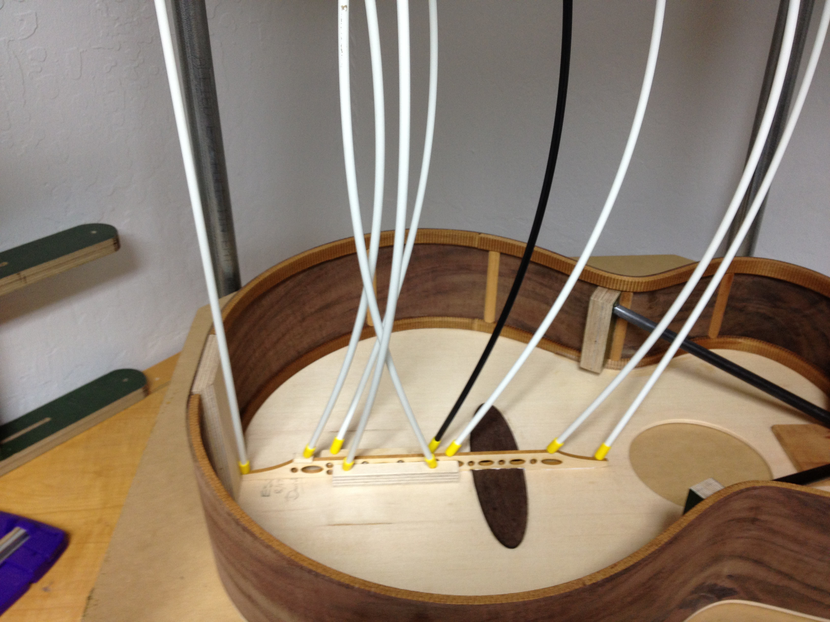

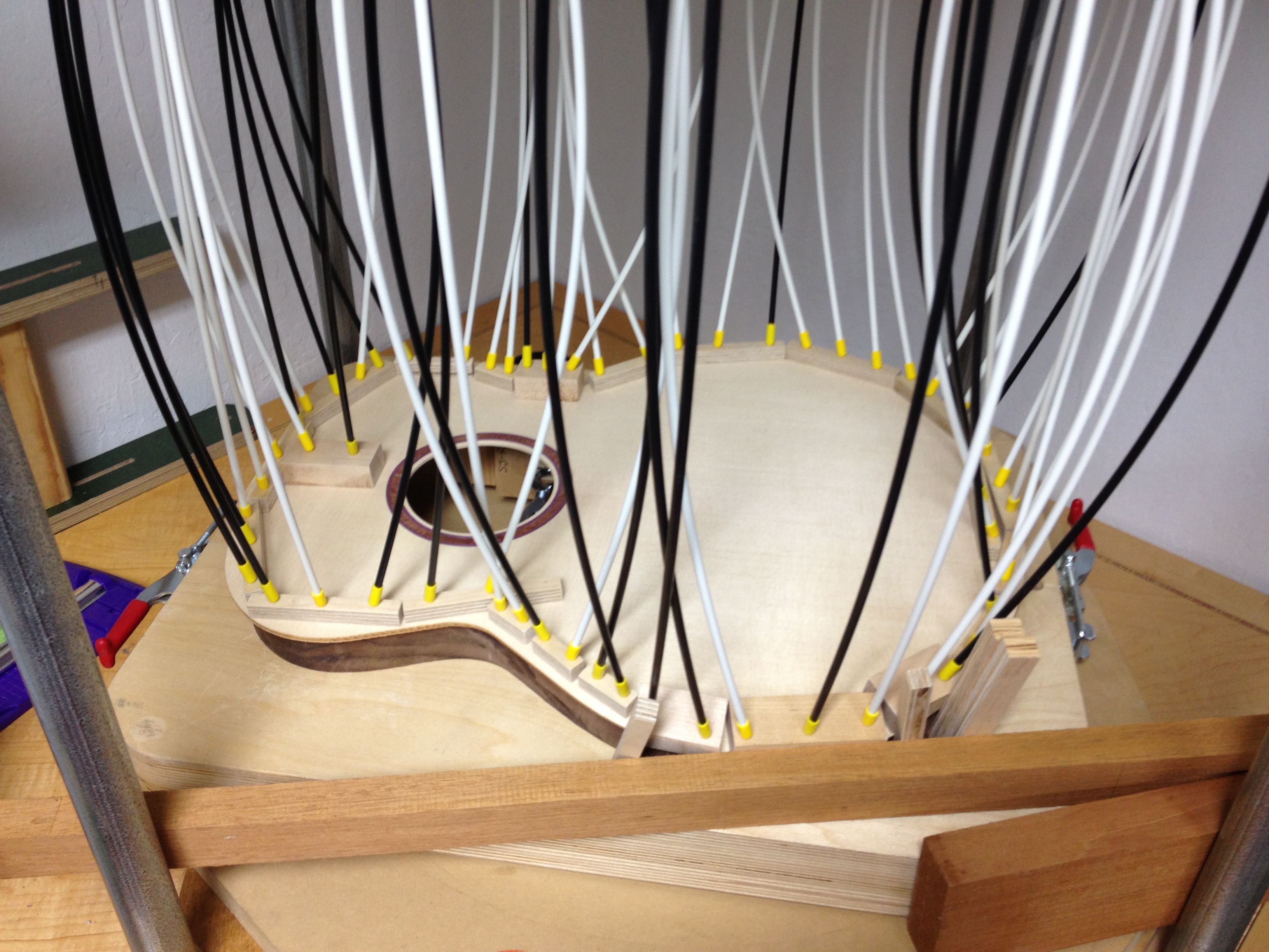

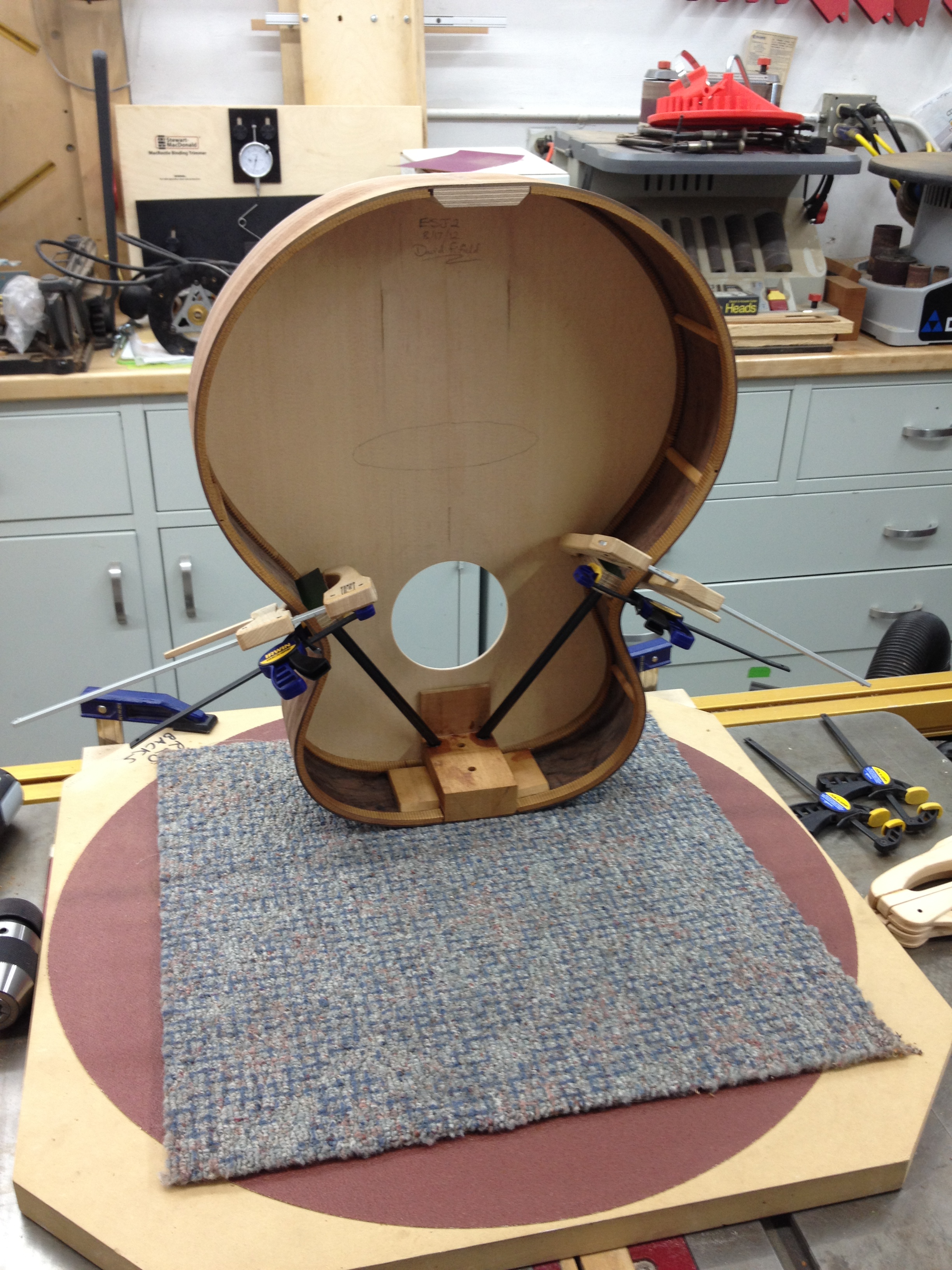

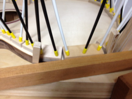

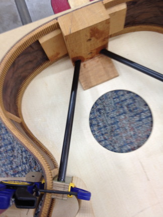

So, here's what happened today (Saturday August 18th):
Unclamped the side braces that I'd left to dry overnight. They came out nicely. Here's a closeup of a typical one:
Then I made some waist blocks from some scrap phenolic birch plywood, shaped them to fit the waist, worked out the angles needed for drilling, then drilled holes in them and the neck block for the two carbon fiber buttress tubes that I needed to stiffen up the whole upper bout and that direct a lot of the string tension into the waist of the guitar, where it is very strong and stiff. I cut the 3/8" CF tube to length then using epoxy glue for the CF and wood glue for the waist blocks, fitted them both and clamped the assembly up. Then went for a nice long dinner to let it set.
Here's what they looked like after the glues were dry:
Then, after deciding that I would probably stick with bridge pins for now, I made a nice hard bridge patch (in my trademark oval shape that matches the bridge shape I use) from a piece of Katalox. This wood was given to me by Peter Hurney in payment for doing some laser work for him (on a Monarch butterfly inlay), so again, cost = $0!!
I glued the bridge patch in using the go-bar deck:
Then I contemplated the stiffness of the soundboard. I think I may have gone too thin on the top and bottom skins. It was not as firm and stiff as I'd like, and certainly nowhere near as stiff as the ESJ1 (first version of my experiment). So, I decided I needed to add just one stiffening brace that would stiffen up the bridge area and prevent the guitar from bellying (eventually). I used the laser to cut it out. Here it is being glued in:
And here it is after gluing:
This was a leftover piece of the brace material from the back of the guitar, so once again, no cost adder :D
Tomorrow it will be time to prepare the back/back braces/side mortices to accept them and then glue the back on! By tomorrow night, the box will be closed and ready for binding/purf....

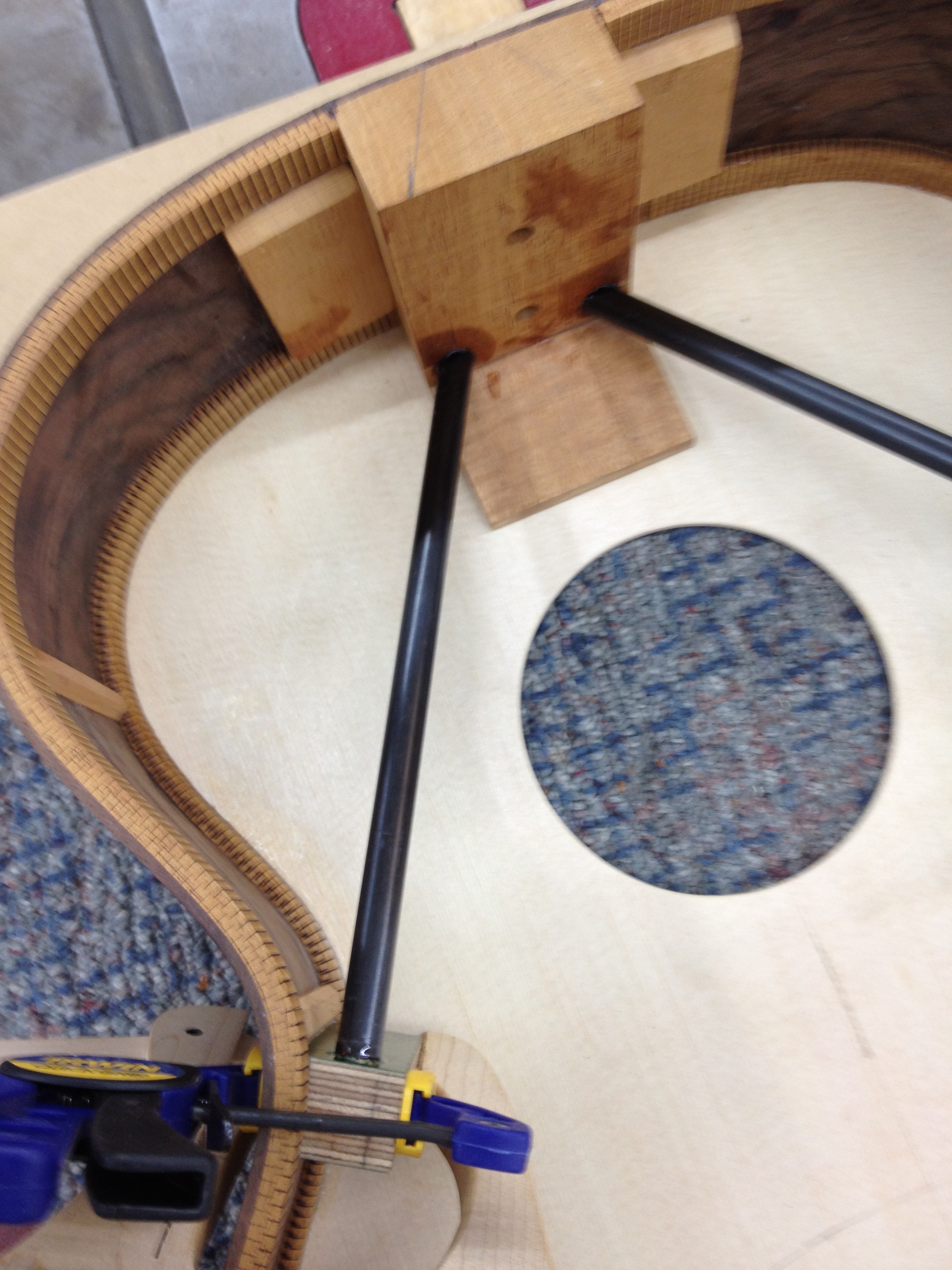

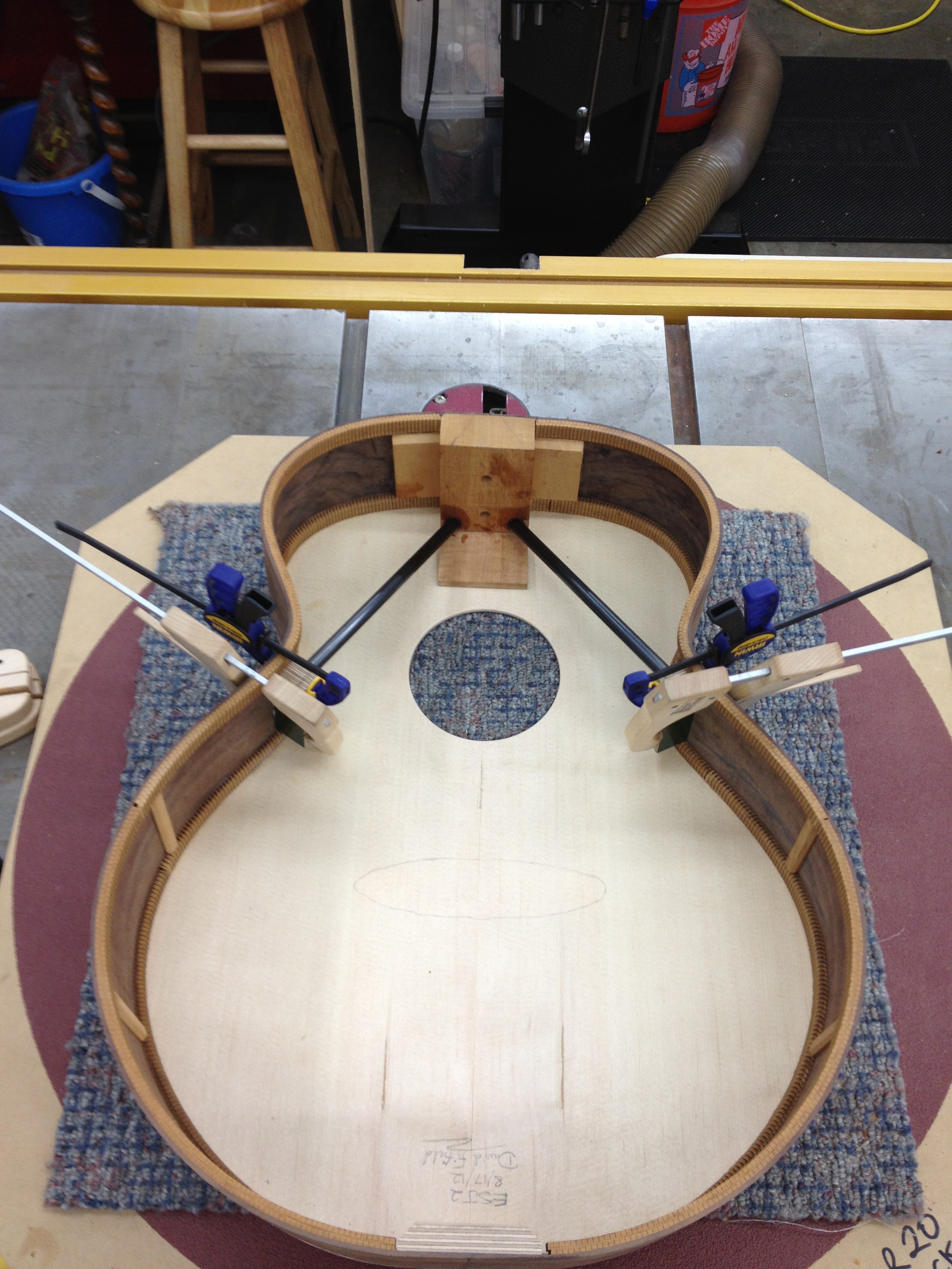

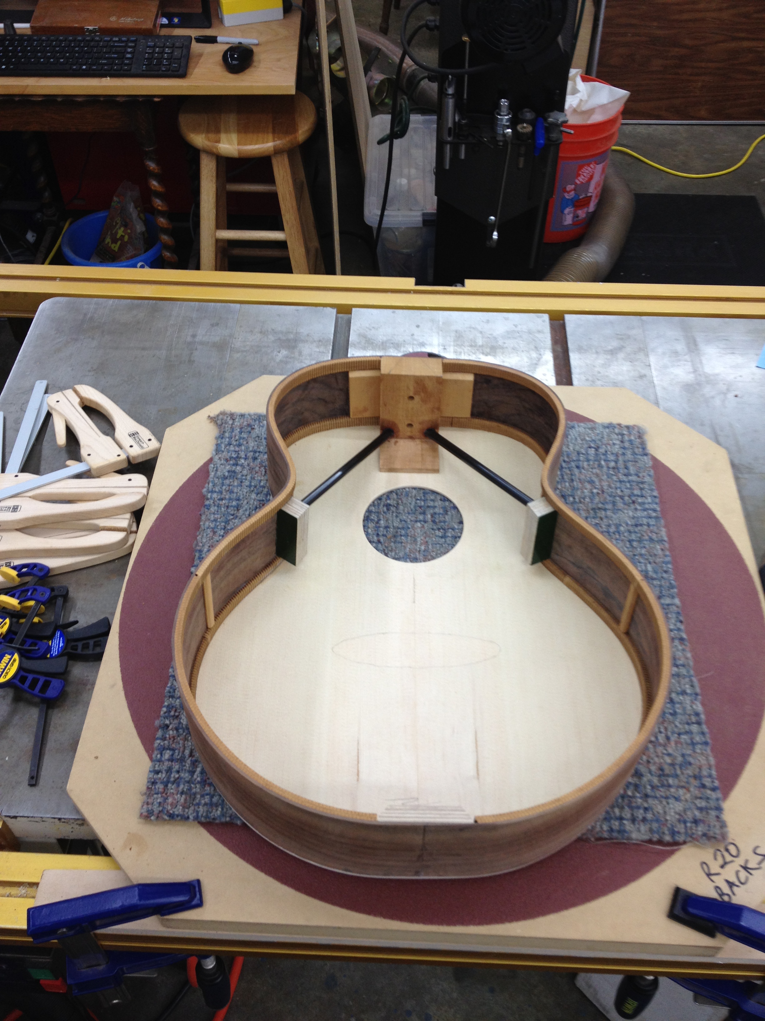

So, here's where my build got to by close-of-business Sunday night:
I cut the pockets (mortices) for the back brace ends into the kerfed lining on the sides.
I made a simple new jig to do this. Previously, I balanced my Dremel/Stewmac base on a pair of metal straight edges, but this was not a very stable set up and almost resulted in disaster several times when the straight edges moved! I laser-cut the new jig from 1/4" thick acrylic sheet. I also made a new oversize base for the Stewmac Dremel holder, so that I could use my digital Wixey height guage to set the bit height accurately. Here's a short vlog showing the pocket routing process:
Then I trimmed the back braces to length and glued the back on in my go-bar deck:
A few hours later, I took it out and routed/sanded the excess from the edge of the back, and here's how it came out:
All ready for binding/purfling [:Y:]

I've been away from my 'shop for a short while - wife and son #2's birthdays, cutting 6" off the back of an entertainment unit for one of my wife's pals, helping my buddy Bill work on his uke, inlaying some MOP shark fins onto his uke fretboard, etc. Here's a piccy of the inlays FWIW:

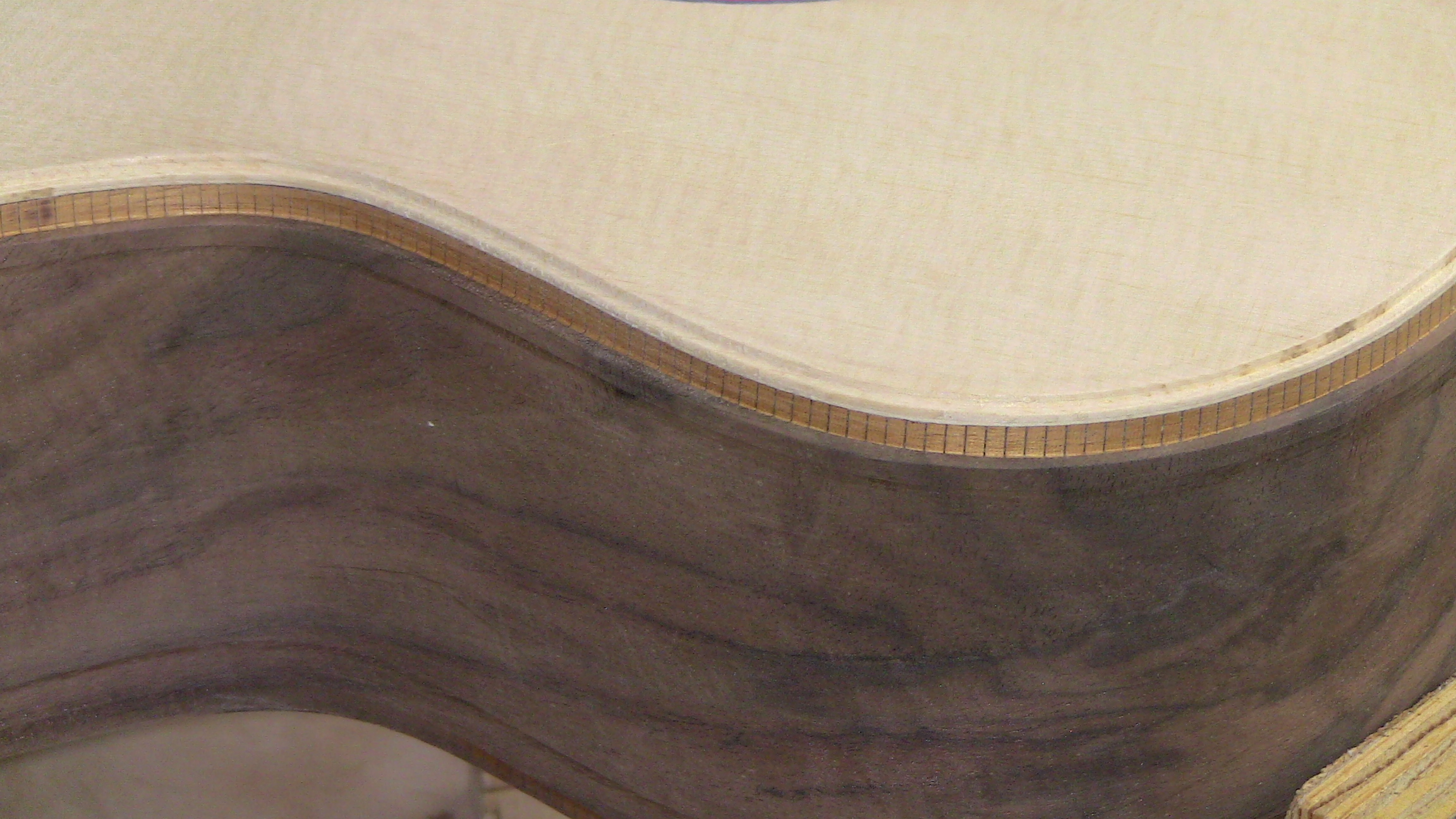

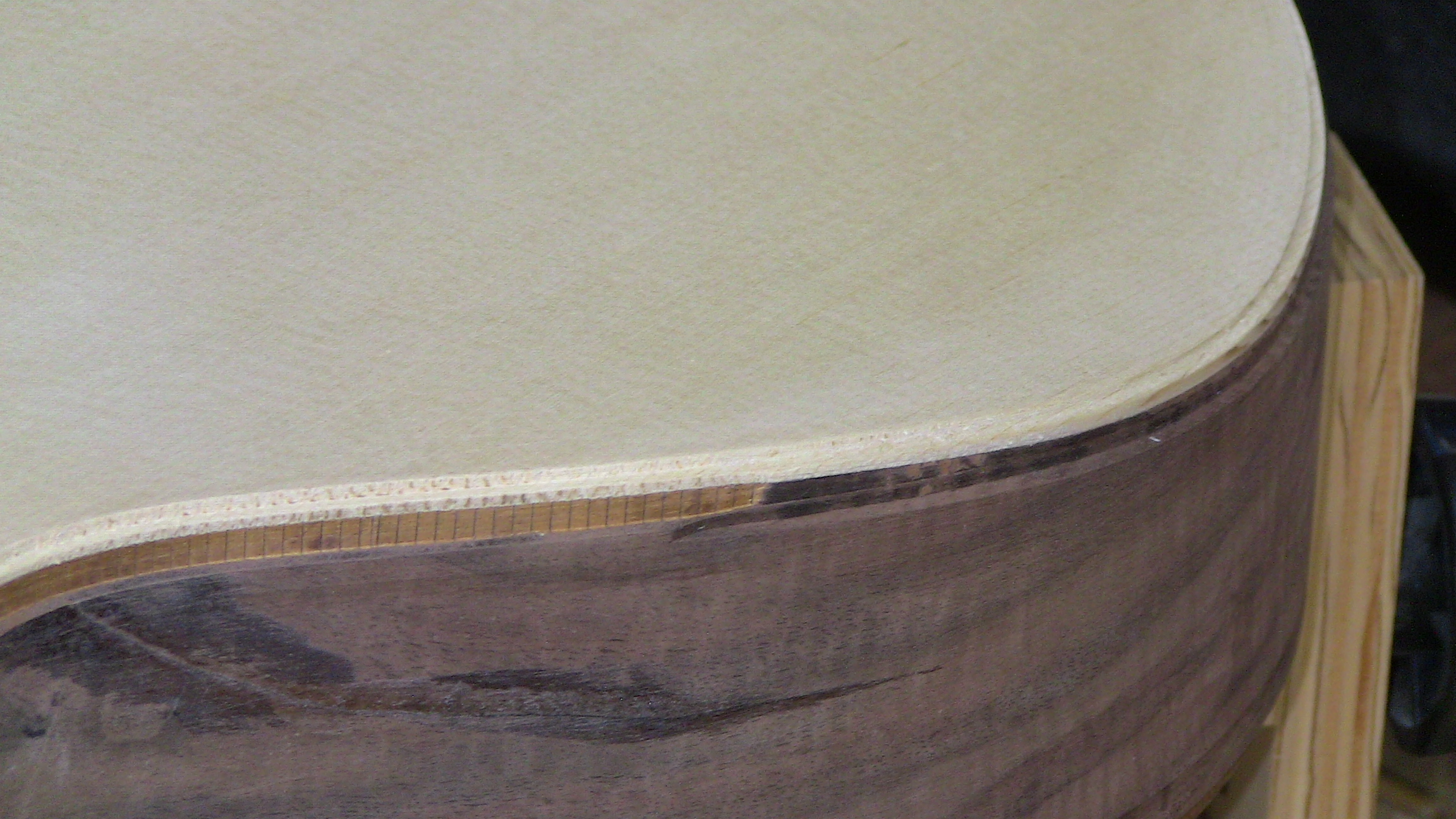

Tonight I worked on routing out the binding/purf channels.
The channels around the smooth bevel area are proving to be a distinct challenge.
I will have to finish them off by hand with chisels as I suspected.
I'm racking my brain (duh.....what brain was that?) to try and come up with a jig to cut them accurately.

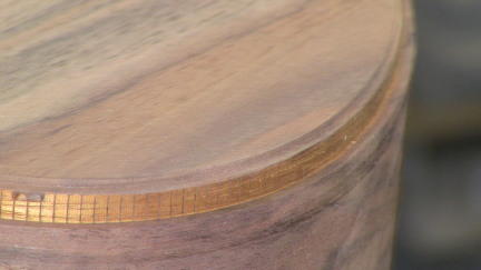

Another thing that's a bit disconcerting is that the routed channels have exposed the linings and let all the kerfings escape! Not sure what to do about that?....
Here's some piccies:
First one shows the binding/purfling channels on the "normal" bit of the top
Second one shows how the channels don't exactly line up at the boundary between the smooth bevel and the normal bit. I have some work to do in this area in particular...
Thirdly, here's a shot of the back channels. It's gratifying to note that the back braces were let into the sides almost perfectly (height wise).
Binding bending time tomorrow....fun, fun, fun!

Steve/Tony - you guys are great! I found the bucket of kerfings in my workshop when I got over here tonight, just where Tony said they'd be - excellent! [clap]
Here's a short video of the kerfings restoration process. As you will see, they did the trick!
